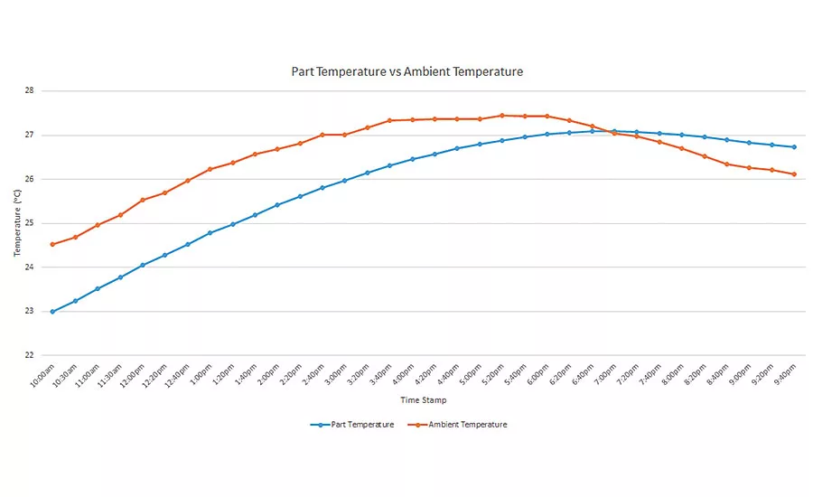

Figure 1: Part temperature vs. Ambient Temperature Source: Sciemetric Instruments

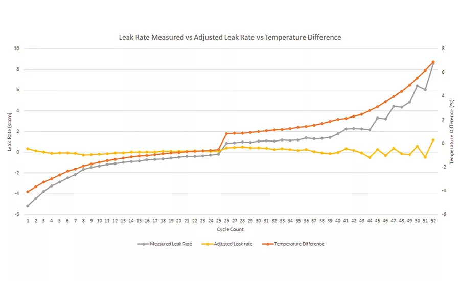

Figure 2: Measured Leak Rate & Adjusted Leak Rate vs. Temperature Difference Source: Sciemetric Instruments

Figure 1 is an example of how part temperature (blue) and ambient temperature (orange) changes throughout the day and highlights how the part is delayed in warming up compared to the ambient temperature, due to its size and material density.
Figure 2 demonstrates the variance in reported/measured leak rate (grey) that arises when the part is either warmer or colder (orange line) than the ambient temperature. The yellow line indicates the adjusted leak rate results when the temperature variance is accounted for—the result is much more consistent accuracy in the leak test.
